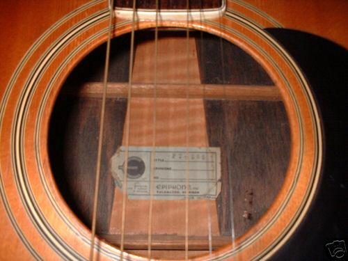

My guess is that the bolt was added by a non luthier when the guitar first needed a neck re-set. Looking at pictures of the FT-565, there shouldn't be a bolt running from the heel to the neck.
See, no bolt from heel to neck. JBreault39001.4633564815

Joe, In your second picture there is something visible near the top of the neck block. That is where the bolt is located in this one. This bolt is countersunk into the neck block and in my opinion looks much cleaner than I would expect a non-luthier to accomplish; especially given that its location on the neck block would make it difficult to achieve through the sound hole. Michael, I had considered the possibility of a conversion. Removing the nut does not loosen the neck joint at all.
